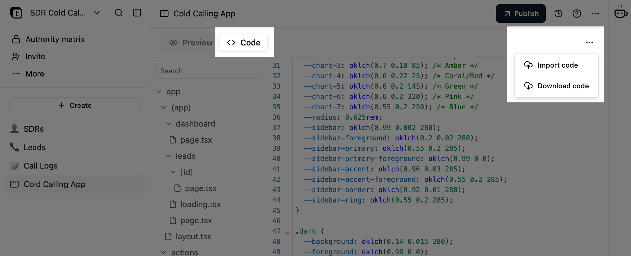

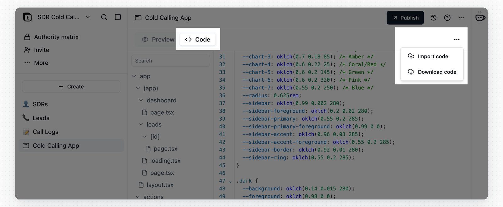

Download Code
You can download the entire app as a ZIP archive at any time:
  1. Switch to the Code tab in the editor.
  2. Click the ... menu in the tab bar.
  3. Select Download code to save a ZIP archive that includes all source files.
The archive holds a root .env file with the platform-injected runtime variables only, including the access token; credentials granted to the app are not part of it. Review the contents before sharing the ZIP.
Import Code
You can update the app’s code by importing a ZIP:
  3. Select Import code and choose a ZIP file up to 20 MB.
  • Include source files only. node_modules, .next, and other build artifacts are ignored automatically.
  • The ZIP replaces the existing project. Files you leave out are removed from the new version.
  • If the ZIP contains one wrapper folder, Teable strips that folder. You can compress the outermost project folder directly.
  • The imported project must include package.json at the project root.
  • Custom variables in a root .env file are stored as your secrets and granted to the app under the same names. Other .env* variants, such as .env.local, are ignored.

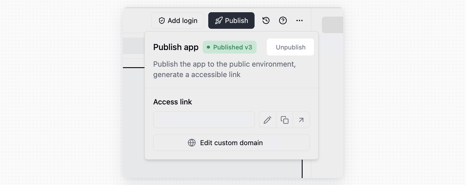

Publishing Your App
When your app is ready, click the Publish button (arrow icon) in the top right corner.
  • Public URL: Teable generates a secure, publicly accessible URL for your app.
  • Custom Domain: Map your own domain to the app.
  • Show branding: Use Show branding in the Publish menu to control whether the published app shows the Build with Teable badge. If you change this setting after publishing, click Redeploy to apply it.
  • Unpublish: For a published app, use Unpublish in the publish menu to take the public link offline.
  • App configuration changes: When the publish menu shows Runtime configuration changed. Redeploy to apply it to the live app or Branding setting changed. Redeploy to apply it to the live app, click Redeploy.
  • Open published app: Once an app is published, the icon next to Publish opens the live app in a new tab.
Hiding the Build with Teable badge requires the Business plan or above.
Publish app menu For a public website example, see how Waconzy brings music, tools, and digital services together with App Builder.
Unpublish an App
To take a published app offline, open the Publish menu and click Unpublish. After you confirm, the public app URL can no longer be accessed. Unpublish app button in the publish menu Unpublishing does not delete the app or its edit history. You can keep editing the app and publish it again later.
